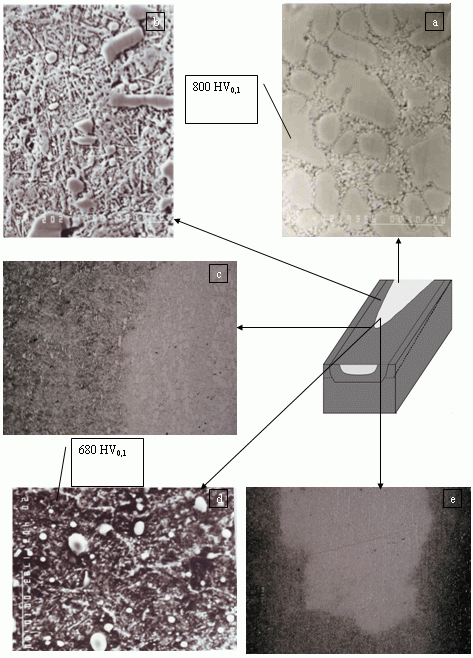

                Fig.2. Microstructures in the typical zones of the combined plasma-arc treatment and surface plastic deformation
3. Results and discussion
By combining plasma-arc and surface deformational treatment are formed several typical zones with different structural and mechanical characteristics. In most conditions, a zone with full melting forms on the surface, transforming smoothly into one with partial melting, and respectively into a zone of hardening from hard state (fig.2). Under high speed of cooling, crystallization in the melting zone occurs with formation of thin dendrite structure from austenite, satiated with chrome and carbon (over 80%), which maintains its stability until reaching room temperature. The end of the crystallization goes in the interdendritic spaces with formation of two-phased carbide-austenite (ledeburite) structures, or after prolonged cooling, of carbide-martensite ones.

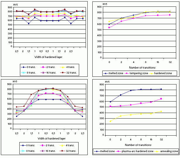

The formed structure and the microhardness in this zone practically don't depend on the massive thermal treatment conducted in advance. Right after the plasma-arc treatment, the hardness is within 550-600 HV and after surface deformational impact it reaches 780-820 HV. The increase of the achieved deformational strengthening is over 30% and the speed of the increment is highest until the eighth transition, after which it fades (fig.2). The depth, until which this treatment is significant, is 0.05 - 0.07 mm, which is determined by measuring the microhardness of an oblique specimen. The effectiveness of the process of strengthening in this zone, after plasma-arc and especially deformational treatment is related to the possibility of realizing increased dislocated density in the austenite. Especially effective obstacles against the movement of dislocations are the border surfaces of the austenite dendrites, which contact with relatively harder and non-deformational carbide-martensite mixture [8]. The examined intensive strengthening after surface deformation is also due to activation of processes of dynamic deformational aging, which is characterized with segregation of alloyed atoms over the numerous dislocations [7,8].
After conducting X-ray structural researches on samples of similar steel X12, which passed the same treatment [6], it wasn't experienced any deformational activation of the process of transforming the satiated with chrome and carbon austenite into martensite.
In the rest of the zones of hardening from hard state - surface plasma-arc and massive one, is observed, even though to less extent, increasing of the microhardness after deformational treatment. This degradation of deformational strengthening is based on the less ability of the more fragile martensite and non-dissolved primary carbides to be plastically deformed. The increase of the hardness in this case is no more than 130-150 HV, which is slightly more than 20%, compared to the 30% of the melted zone, which includes big amounts of residual austenite. No matter the structural non-homogeneity after the eighth deformational transition, equalization of the values of the microhardness is observed (fig.3,4).
                              Fig.3. Microhardness in width in hardened                 Fig.4. Influence of stage of plastic deformation
                                            and annealing specimens                         on microhardness hardened and annealing specimens

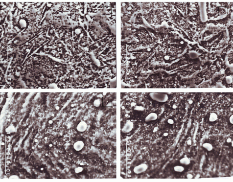

In the microvolumes, where the energy-time parameters of the process of plasma-arc impact are optimum according temperature and respectively the solubility of the carbides, is observed thin acicular and needleshaped martensite with pin's length of just few micrometers (fig.5). The circumscription of their growth is favored by the non-dissolved dispersed carbides. In the adjacent areas, where the temperature is higher are observed thin light layers on the substructural borders (fig.5), where probably takes place an initial stage of melting, which is fixated during the next crystallization.
There are observed interesting structures with clearly marked deformational texture in the relatively more plastic zones of the non-hardened samples on the periphery of the plasma-arc impact. Parallel deformational lines are being formed, with distance between them of 1-2 mm, as well as arranged situation on the direction of the lines of the dispersed carbides with dimensions of 0,5 - 2 mm (fig.5).
                Fig.5. Scanning electron micrograph of zones of the combined plasma-arc treatment and surface plastic deformation

20 - 30%. The most significant is the strengthening of the structures with prevailing austenite phase. After eight deformational transitions occurs equalization of the microhardness of the two typical structures - the austenite-carbide and martensite-carbide.
