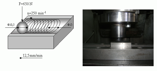

The surface elastic-plastic deformation is implemented with a universal milling machine at rotational movement of the instrument/tool and linear step-by-step shifting of the sample. The tool is eccentrically adhered so that we have a width of the deformed layer of 15 mm. The deforming treatment is implemented with a sphere with a diameter of d=10,5 mm, and the treatment power is F=650 N. The deforming treatment on the surface of the specimens is done with a rotation speed of 250 min-1, circle diameter D=15 mm and linear speed of
12,5 mm/min. The number of transitions N of the deforming instrument is determined by the following law (1):
N = 2i,    i = 1÷5                 (1)
Scheme of linear surface plastic deformation is presented on Figure 1.
                                                       Fig.1. Scheme of linear rotational surface plastic deformation

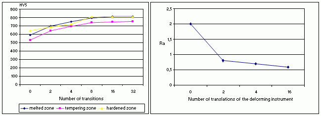

Te application of surface plastic deformation on plasma-hardened layers is one of the options to increase the surface hardness. In current research we observe an increase in every zones, achieved in plasma-arc quenching regardless of the structural condition. In greatest extent increase in hardness is observed in the melted zone - up to 30%, which is logical considering the quantity of austenite inclined to hammer hardening. In lower extent, hardening is observed in the quenched from hard state layers - 10-15% (fig.2).
The expectations for ga transformation in zone with 90% Ares. under multiple surface deformation are not confirmed by the X-ray structural analysis of specimens of steel X12 [2]. Nevertheless, the increased hardness after surface plastic deformation, especially in the melted zone, and the residual pressure stresses suppose an increase in the exploitation durability of the instrument, and from an a priori information is well known that in surface plastic deformation we achieve favorable pressure stresses. In addition, we observe decrease in roughness. Largest decrease of Ra is observed after the second transition of the deforming element. Subsequent deformation does not contribute to significant changes in roughness (fig.3).
               Fig.2. Influence of stage of plastic deformation on         Fig.3. Changes in Ra depending on the number of
           microhardness of hardened and annealing specimens                                   translations

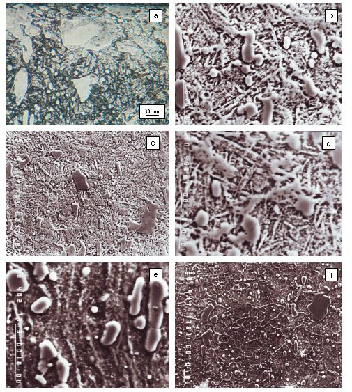

Micro structurally, we note in the plasma hardened layer a deformed texture, which is best expressed in the melted layer, because the austenite possesses more gliding surfaces in its crystal net than the martensite, and therefore, greater depth of the deformed layer (fig.4). In the periphery of the zone quenched from solid state there are formed parallel deformation lines with distance between them of 1 - 2 mm, and ordered location in the direction of the lines of dispersed carbides with sizes from 0,5 to 2 mm (fig.4e). We observe crashes of big primary carbides as well (fig.4 e,f).
Fig.4. Optical and scanning electron micrograph of zones of the combined plasma-arc treatment and surface plastic deformation
